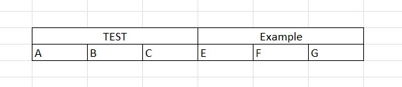

Would like to ask how to add design row/column as per attached below using spreadsheet?
or any other method to create it?

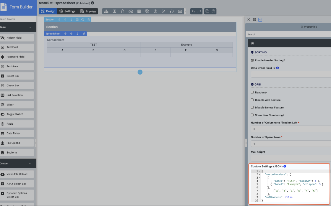

        Hello Christopher, you can utilise the Custom Settings (JSON) Configuration field. Try using the code below to generate your header.
          "nestedHeaders": [
              { "label": "TEST", "colspan": 3 },
              { "label": "Example", "colspan": 3 }
                ["A", "B", "C", "E", "F", "G"]
          "colHeaders": false
        You can refer to Spreadsheet - Knowledge Base for DX 8 - Joget | COMMUNITY for more information on plugin configurations. Happy coding!
