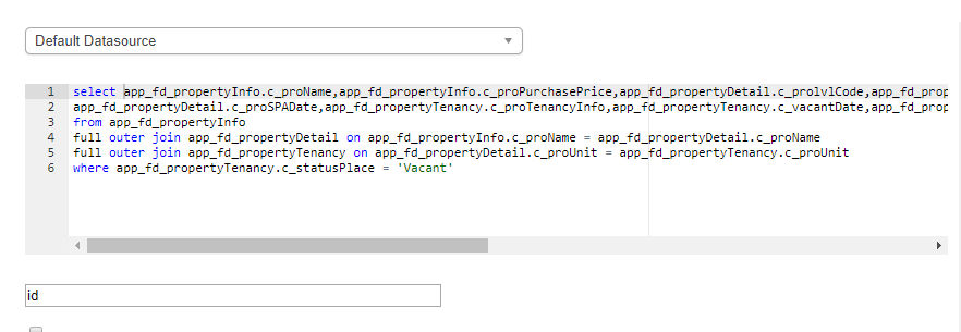

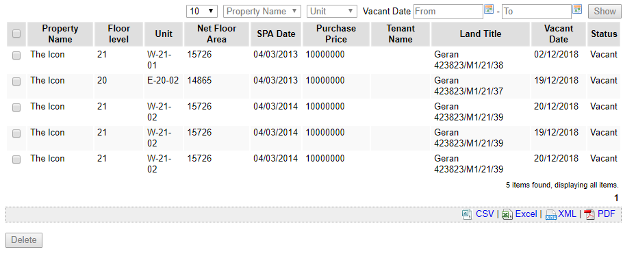

This is my query SQL using JDBC binder in Datalist builder. The in preview option it display the output. BUT In userview it doest not any output. How can this happen?

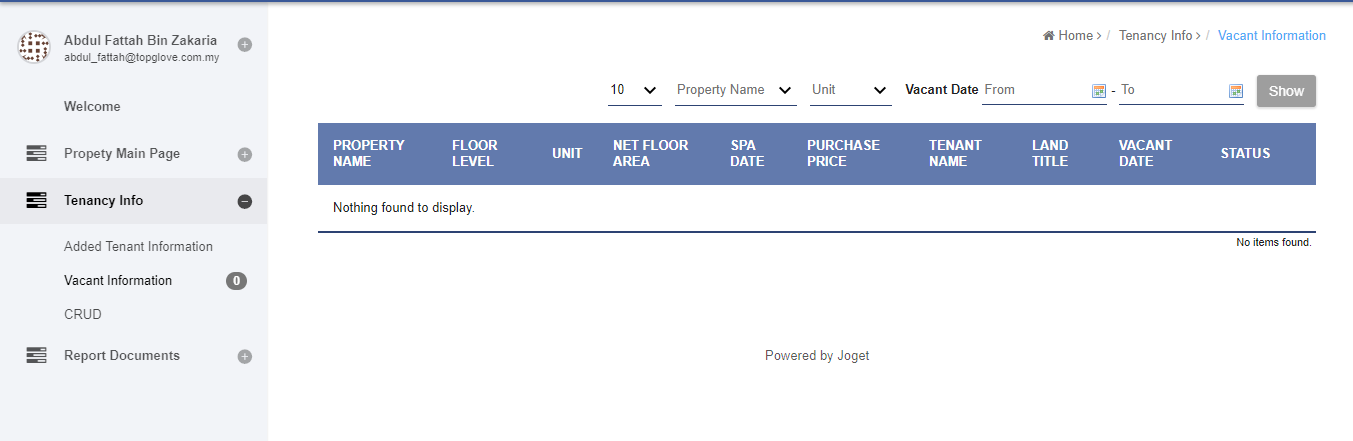

This in Userview site
      the anwer i find out is, we need to query also the id of data. and set the pk the id.
