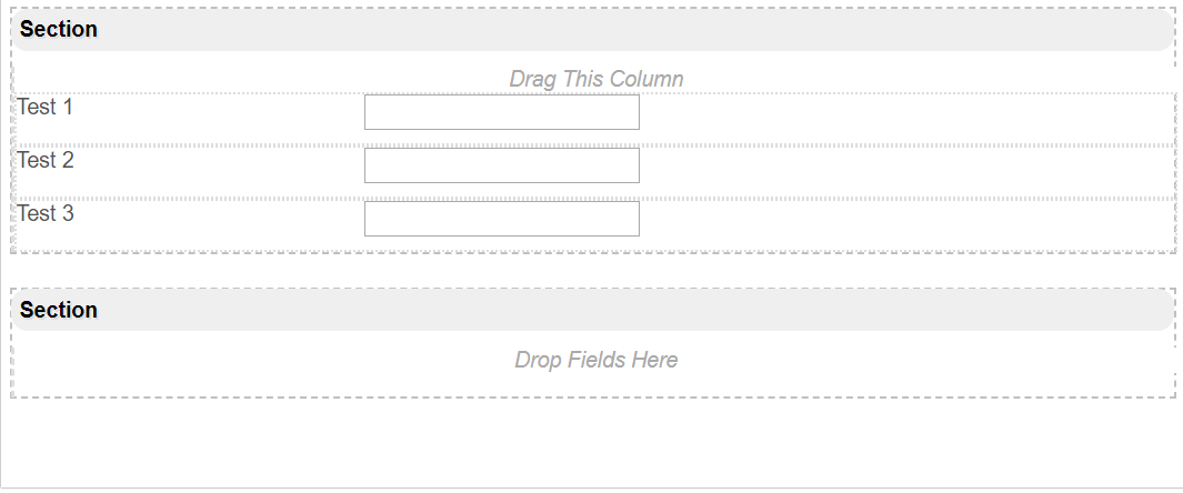

Drop datalist on the form
I have a form and I wanna drop a datalist on the section automatically
It means I can see a form and list on the webside but no need to add.
Thanks :/
      May I ask on what is the relationship with the form content and the list?
      You can add a "Custom HTML" into your form, put in "iframe" code and point the "src" attribute to the datalist in your userview. At the end of the URL path, add "?embed=true" so that it will show up with just the content (list) that you want.

      Hi, you could use some of the grid elements like Grid, List Grid or Form Grid.

        It's not like that, i don't wanna add by hand, imagine you have a section, and you wanna add a list like you see on the user view. please help me :/
