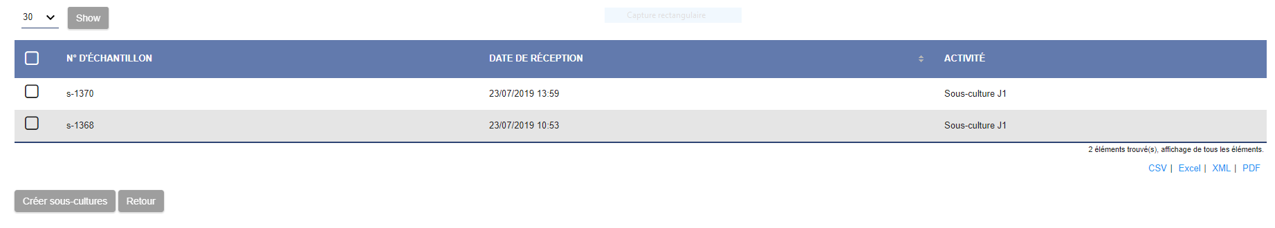

I'm coding a Bean Shell action for a datalist
I'm trying to differentiate the action based on the value of column "Activité".
I understand that the Bean Shell action is fed with "rowKeys" which are the primary Keys of the selected rows. How do I get the "Activité" value of the selected rows?
Thanks a lot
Baptiste
