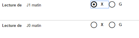

Added to this, loading multiple forms in Subform repeater has strange behaviour with Radio buttons :
In the picture above for instance, all 4 radio buttons are linked (I can only have one selected) whereas each pair corresponds to one record.
This behavior is not systematic and quite random as it can appear or disappear when I refresh the page. It is actually linked to the name given to the control by Joget. it is sometimes the same for both controls (but it should not).Any thoughts?
