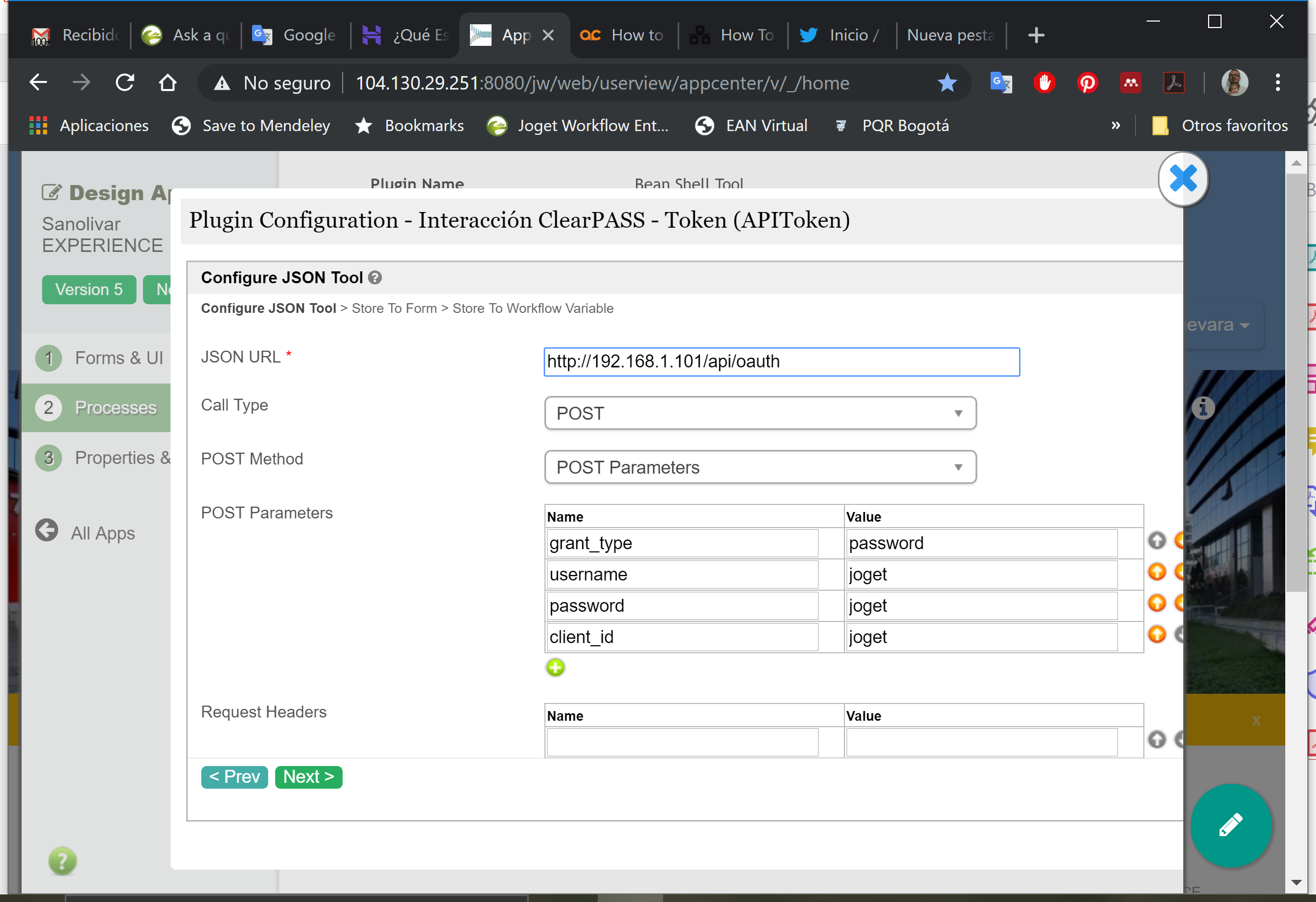

We are developing an integration with Aruba ClearPass through the API. We were already able, successfully, to receive a token through identification with username and password through a JSON type plugin, as I show in the image below.

      Hi, in the JSON Tool configuration there are options for Request Headers. You should be able to include your header elements there.
        Hi. We have followed the indication, however it has not worked for us and the LOG does not give us more information about it:

        Syntax error, malformed JSON.  Is there a way to make this same call through, perhaps, beanshell or similar? As I mentioned, through CURL it works fine.
        1. Anders
          The response error is 400 Bad Request, and the detail says "JSON decoding error: Syntax error, malformed JSON" so it is missing some JSON in the body like in the CURL example. You can try to use Custom JSON Payload instead of POST parameters.
