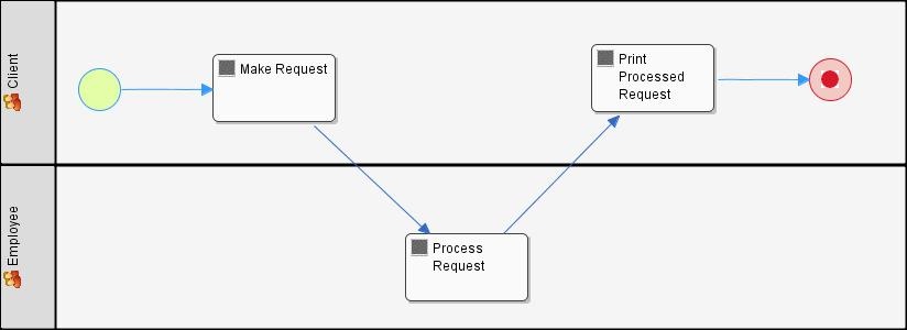

I have the following simple process:
The workflow is as follows:
- A Client makes a Request by filling in a few things in a form.
- The Client enters his name and some other info in the form and sends it.
- Then an Employee logs in and sees that there is a request to process.
- When the Employee opens the form, he should see the information that the Client entered as read-only.
- He can then fill in a Request ID and update the status in the form and finish.
- Lastly, the Client logs in again and sees that his request has been processed.
- He opens the form and it has all the fields he filled in as well as fields updated by the Employee all as read-only.
- He can then print this out.
As you can see, it is quite a simple workflow.
