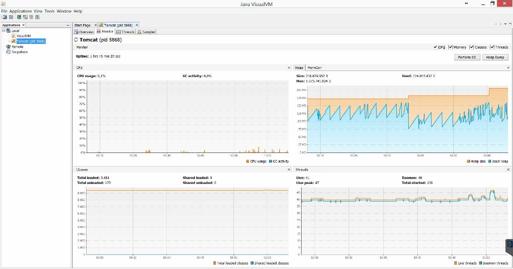

Based on VisualVM, it said :
-XX:MaxPermSize=256m
-Xmx1024M
-Dcom.sun.management.jmxremote=true
-Dcom.sun.management.jmxremote.port=9090
-Dcom.sun.management.jmxremote.ssl=false
-Dcom.sun.management.jmxremote.authenticate=false
-Djava.rmi.server.hostname=127.0.0.1
-Dwflow.home=./wflow/
-Djava.util.logging.config.file=.\apache-tomcat-7.0.52\conf\logging.properties
-Djava.util.logging.manager=org.apache.juli.ClassLoaderLogManager
-Djava.endorsed.dirs=.\apache-tomcat-7.0.52\endorsed
-Dcatalina.base=.\apache-tomcat-7.0.52
-Dcatalina.home=.\apache-tomcat-7.0.52
-Djava.io.tmpdir=.\apache-tomcat-7.0.52\temp
with snapshot as follow :
Thank you for your kind reply,
Regards.
The graphs looks normal to me. And its unusual for you to experience these. Can you supply us with your log files to inspect? A thread dump at the time of incident would be great as well to examine what's running.
