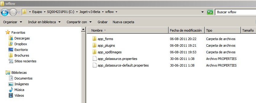

Gagarin Sepúlveda León
I have installed the version 3 Beta and the Workflow Designer is missing. The file http://localhost:8080/wflow-wfweb doesn't exists in the folder.
Anybody could help me how to install this piece of software?
This is the image from my C: drive ?
Thanks in advance
Tiensoon
The context for Workflow Management Console has changed to /jw in v3. So, you may try http://localhost:8080/jw in your web browser, after starting up Joget Workflow server. Alternatively, in Windows installation, you can also open the "Joget Workflow v3 Beta > Web Console" from Windows Start menu.
