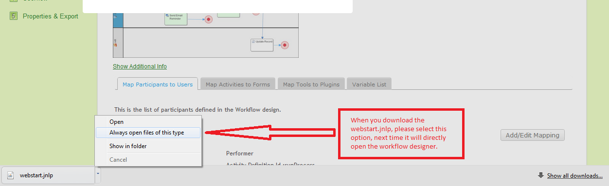

Please refer to the screen shot below.
Hope it helped.
johnjohn123
thanks for the reply, it help but i had re-install Java on my machine and currently the workflow designer is launching without problems.
