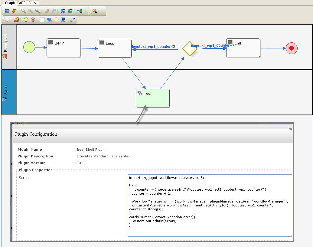

I'm not a developer,and I'm not good at javascript as well. But, I found samples of beanshell usage and have a try. It didn't work out.Would you please what's wrong with it. Thank you

Check the hash variable you used. The syntax should be #variable.looptest_wp1_counter#
