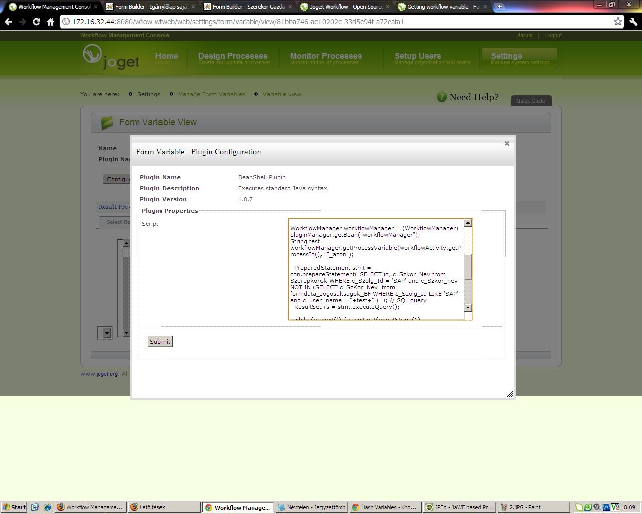

Hi Miklos, the #variable.variableName# Hash Variable can't be used in Form Variable. Technically speaking, some hash variables are dependent on assignment object, which doesn't exist in Form Variable.
The alternative is, you can use Java API to get variable value in your case. Look at the example discussed here: Getting Workflow Variable

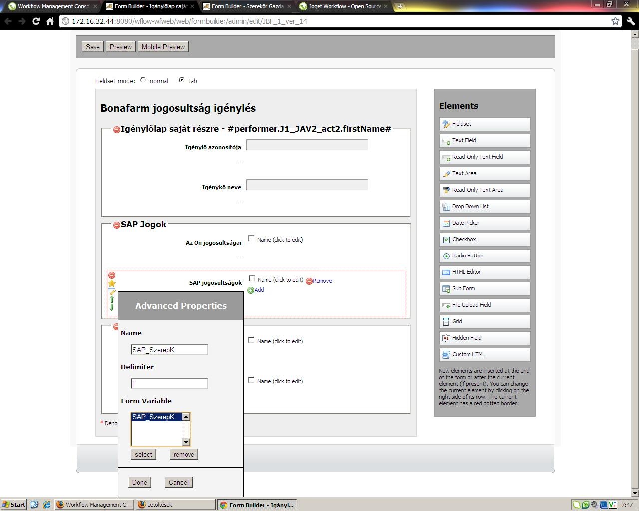

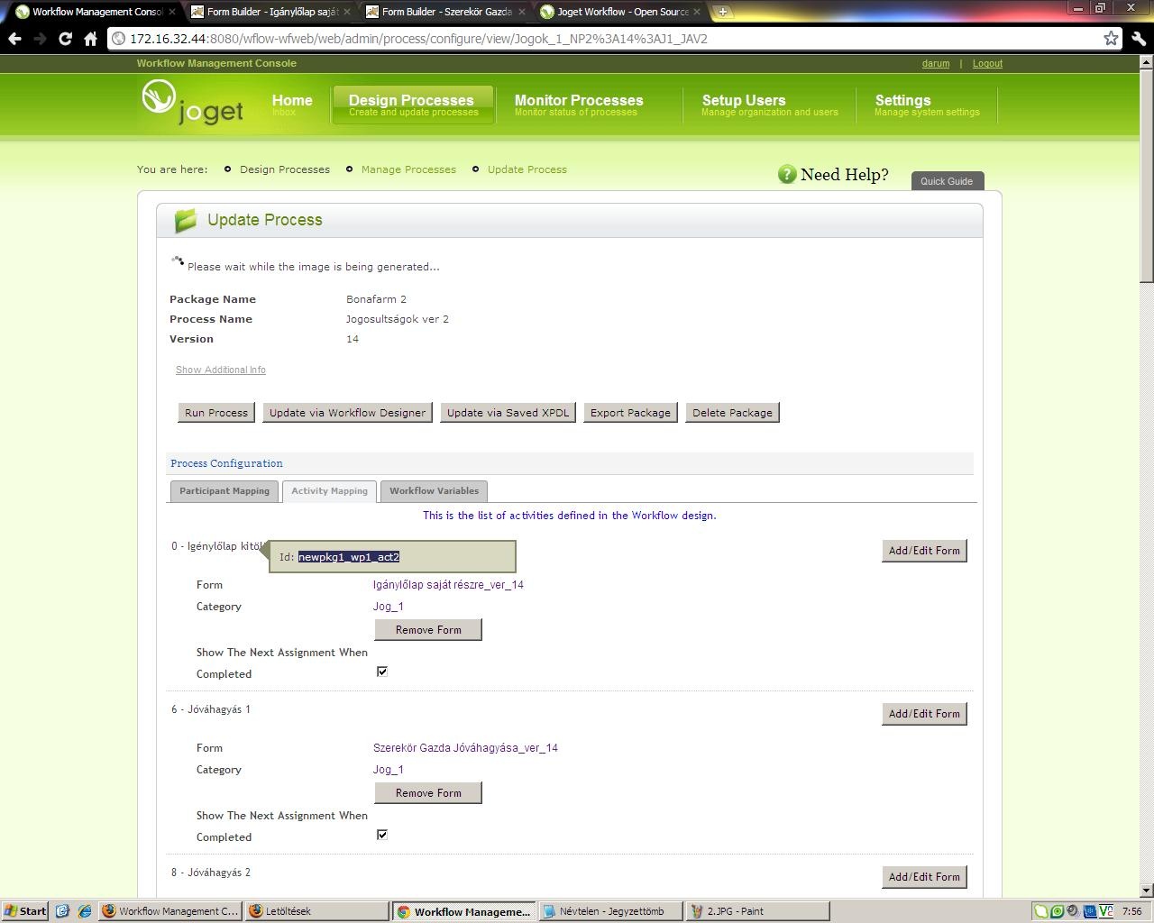

I try to use this code but not working. I make lot of screenshot from our project. Pls let see the workflow,
We are testing to 2 options but not working. We have got same problem than before.
My company are thinking change to Joget workflow manager but it was a very important for my company, we use a workflow variable, formvariable in beanshell plugin. Always we stopped because can't get a variable value. Pls looks my pictures and I will wait your answer.
