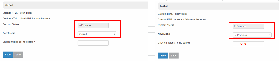

Hi Masters,
I have a question, I would like to check if two text fields are the same.
If they are the same, then in the field "check" I would like to see "YES". I was trying to write some javascript but without success. Can you have a look into this one please?
Field:
status_current
status_new
check
APP_TEST_COPY-1-20160427174736.jwa

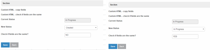

      Hi All,
      I have managed to make it work, if there's a place to optimize, please share your suggestions.
      Thanks,
      Sylwester
      <script type="text/javascript">
          $(document).change(function(){
              var d1 = "status_new";
              var d2 = "status_current";
              var fieldId = "check";
       //get values
              var d3 = $('[name='+d1+']:enabled').val();
              var d4 = $('[name='+d2+']:enabled').val();
      //function to compare
                diff = "NO";
                if (d3 == d4) {
                 diff = "YES";
              //store the value to a field
              $('[name='+fieldId+']:enabled').val(diff);
      </script>
