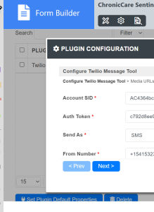

Hello everyone, I’m having an issue with the Twilio Message Tool plugin. I’m trying to test it within a process, but when I run the test, the message doesn’t get sent to the number I entered. For reference, I’m using a Twilio free trial number.

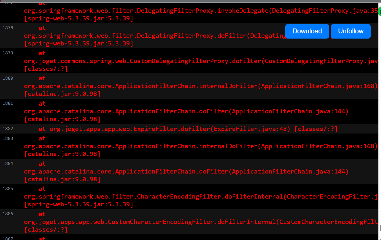

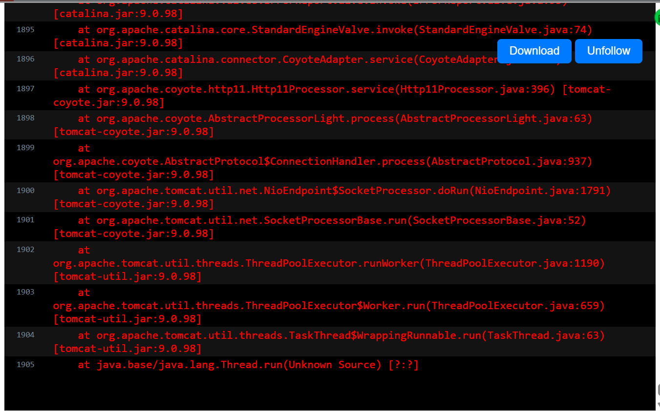

        Here is the system logs
          Hi, what exceptions are you getting in the logs? That should give an indication of what the actual problems are.
